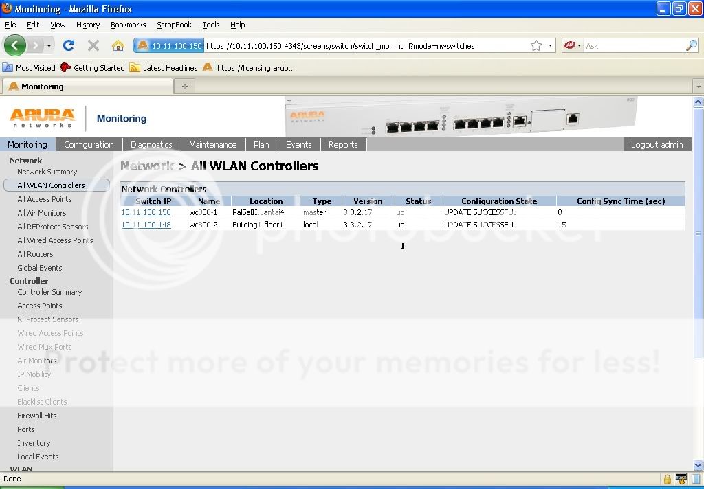

Hi, i have A800 (master) controller running on the network. First time, we can use location track for the user. But when i add 1 more controller, because the AP connected was up to 18 units, we can't use location track.
I had check the database is not syncronization
Is that happen to the database? Or any miss setting the controller? Appreciate for your help.

Database synchronization only occurs in a master-backup master relationship; it does not occur in a master-local relationshp.
Location tracking works in the user-table for users that are on APs that are on the master controller only. For location tracking for users that are on local controllers, go to the plan tab on the master controller, select your building and click on locate devices. You will then be presented with a dialog and you can paste any mac address in there for a client or device you want to locate.

Hi cjoseph, thank you very much for your help :). I will try your suggestion later. But from the capture screen i can't found out the "locate device" button, is it same with "add device" button?
Please help, thks before.... :D

Add Device
Yes,
It is "add device".
I apologize.

Hi Joseph,
It's works well now.... :D
thks anyway
