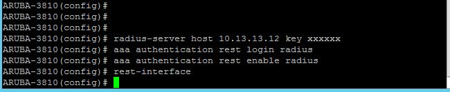

Now, in order to achieve RADIUS Authentication for REST, configure the switch with the following configuration:
These are the REST specific commands that are required.
The IP address 10.13.13.12 is of the Clearpass server.
The command "rest-interface" is used to enable REST on the switch.

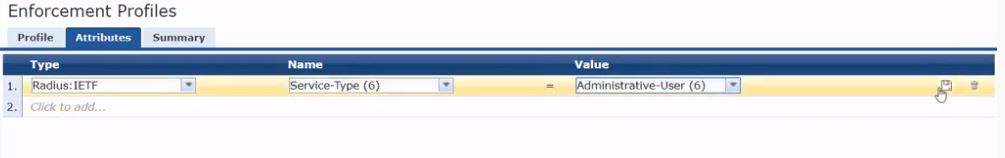

2) Create a profile :
You can name the profile as you desire.
Click on the Attributes TAB and configure the following:

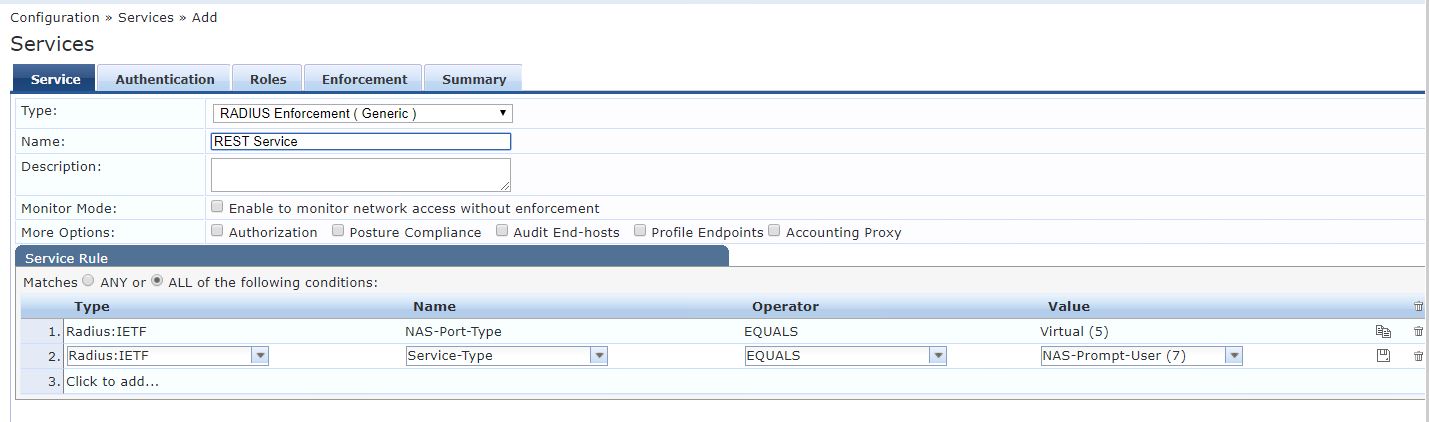

3) Configure the Service as follows:

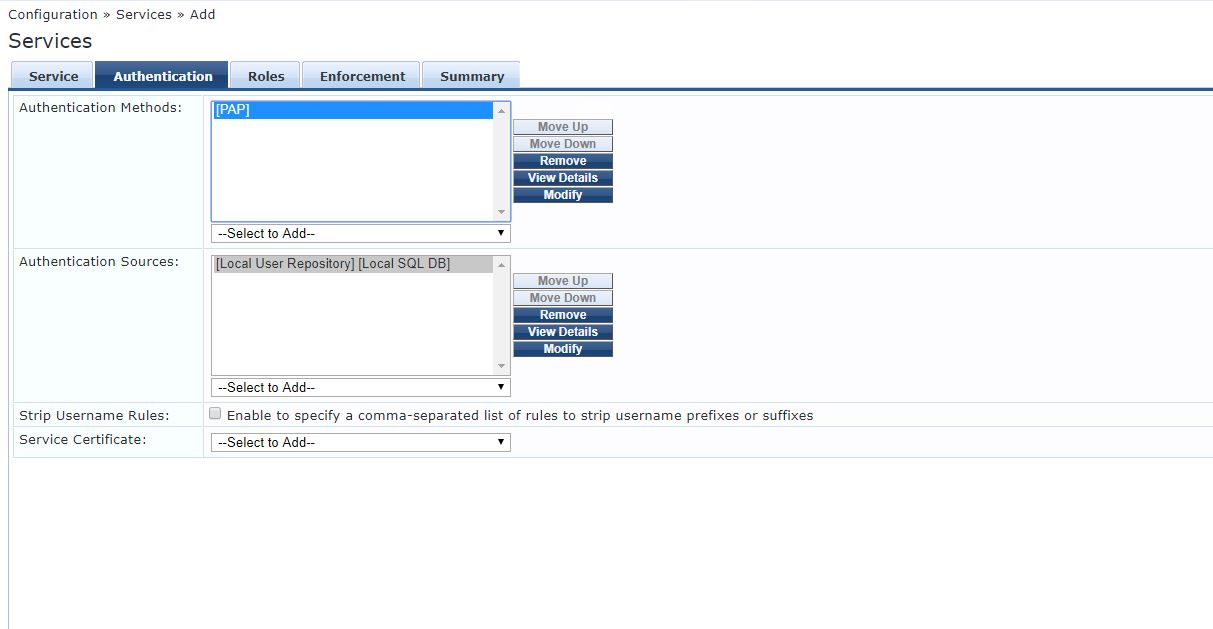

4) Under the authentication TAB select PAP and Local User Repository in the Authentication Methods and Authentication Sources respectively:

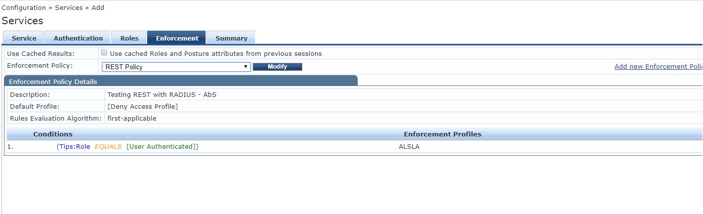

5) Finally, click on the Enforcement TAB and select the policy that defines the condition:
