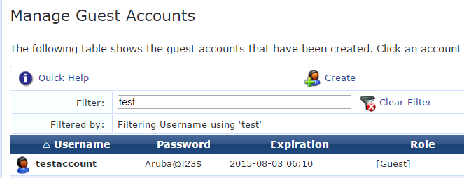

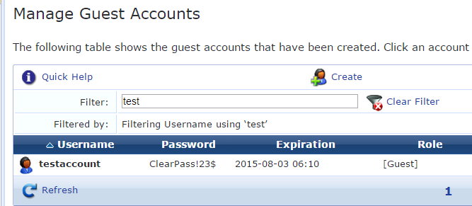

To verify that all the operations are being performed via the API call we can login to the Guest module and observe the Manage guest accounts page.
Verification of the create account
Verification of the update account
