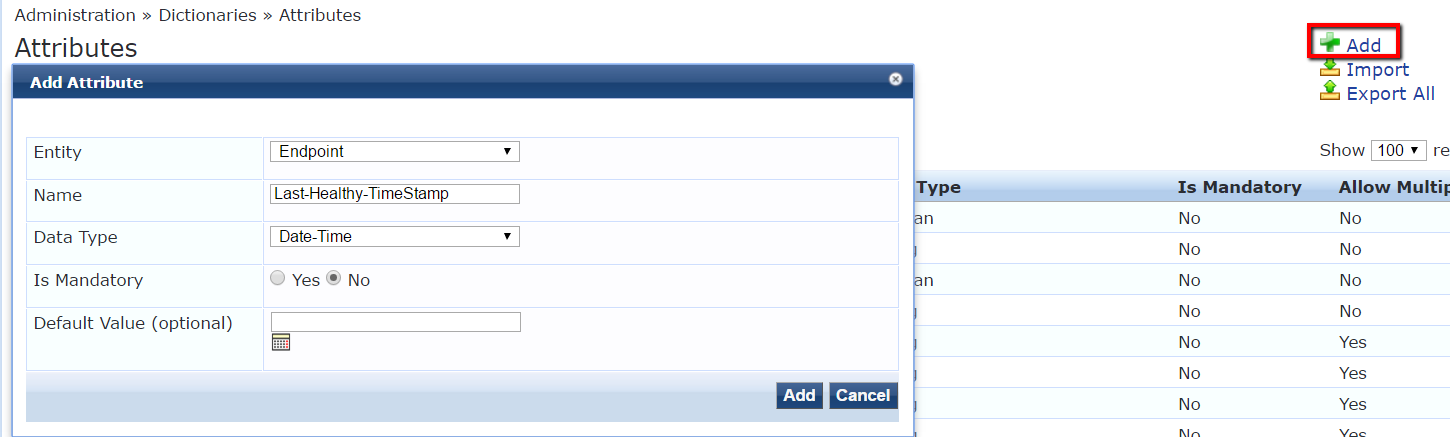

We need to navigate to Administration>>Dictionaries>>Attributes  and click on Add as shown in the screenshot below to create new attributes.
Last-Healthy-TimeStamp is the name of the attribute, the Datatype is going to be Date-Time so that we can use it to tag the Endpoint Healthy Timestamp.
The other attribute we need to create is the "Last-Health-Status" which should be of Datatype String so that it can carry the last health status of an endpoint.
Once we create these two attributes we should be able to use them in our configuration and update these attributes with the appropriate values.

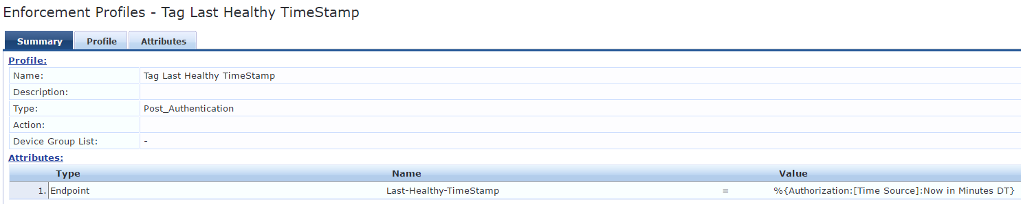

Once we have this filter ready we can use this to update the Endpoint with its value using an enforcement profile as shown below
Similarly we can also update the Endpoint with the Last Health Status using an enforcement profile as shown below
so that we can check for Health Status along with the TimeStamp.
Both these enforcement profiles can be used in the WebAuth service to tag the Endpoints with the Last Healthy Timestamp  and also the Last Health Status when the client is Healthy as shown in the screenshot below

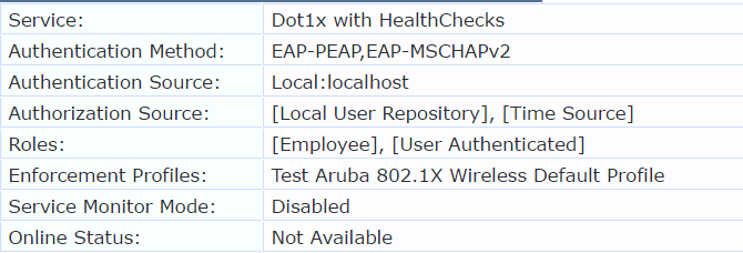

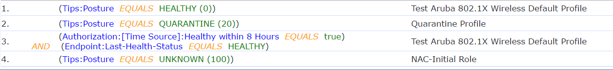

Once this is configured you should be able to reference it in any service. Your enforcement conditions could be configured as shown below in the service.
You should have the conditions having "Posture" above the condition that is referencing the "Healthy within 8 Hours" value as Posture is always current than endpoint attributes.
Once this is configured we can make sure that any requests that the NAS devices send without a corresponding WebAuth (due to no disconnect at the interface level) would be handled and the clients can be avoided from falling in the Initial Role and losing network connectivity.
We can verify that if we see a WebAuth request with the client status as Healthy we are updating the Endpoint with Last-Health-Status and also Last-Healthy-TimeStamp
and subsequently if we see an authentication request without a corresponding Webauth within the next 8 hours you should be able to put the client in the post-auth role directly without having to goto the NAC initial role seeing that "Healthy within 8 Hours" is true.
