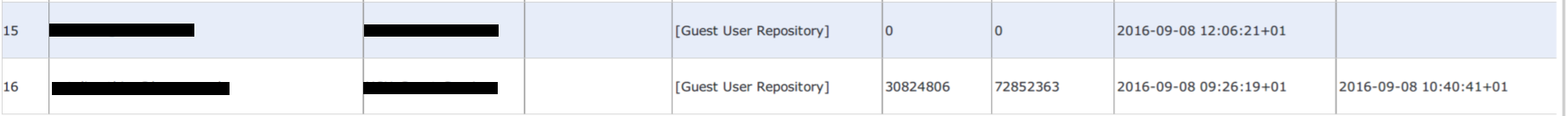

With accounting interval set to 0 on IAP, an example ClearPass report for guest users shows that :
1. Input / Output bytes show 0 for an active session i.e End-time is NULL.
2. When the client session ends, i.e RADIUS accounting stop records End-time along with Input / Output bytes.
