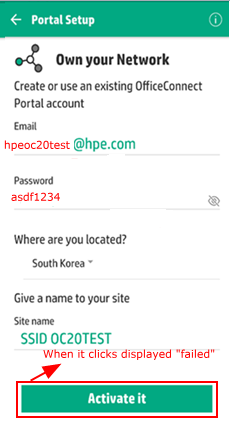

Problem:
Device: HPE OC20 802.11ac (RW) Access Point.
Issue: Unable to activate the network.
Diagnostics:
When configuring the  AP using the Mobile APP (HPE OfficeConnect WiFi Portal), after providing the email and password, when clicking on Activate, it fails to ACTIVATE.
