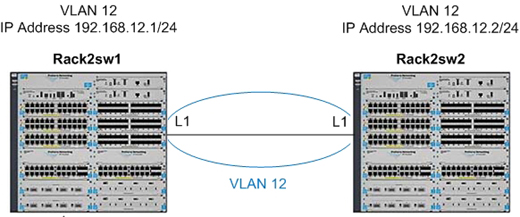

In the diagram, two Aruba switches are configured for IPV4 and OSPF. All interfaces are configured for OSPF area backbone.OSPF authentication has only been enabled on Rack2sw1. The debug output indicates that switch Rack2sw1 is sending MD5 authentication, and switch Racksw2 is sending no authentication.
