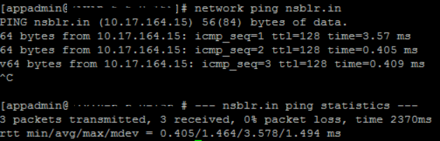

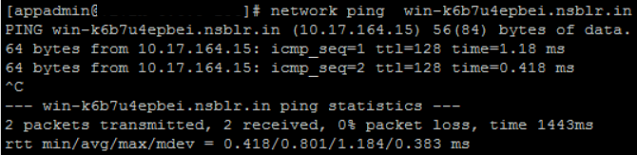

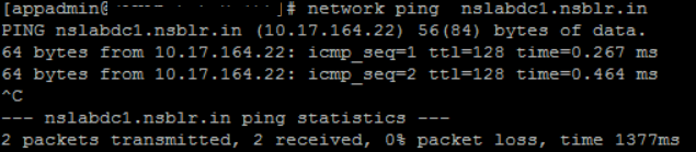

Network Ping individual FQDN DCs shows their IP addresses:

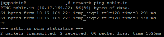

In this instance, Network ping domain name - nsblr.in shows the response is from the first domain controller(NSLABDC1.NSBLR.IN)
In the second instance, Network ping domain name - nsblr.in shows the response is from the second domain controller(win-k6b7u4epbei.nsblr.in)
