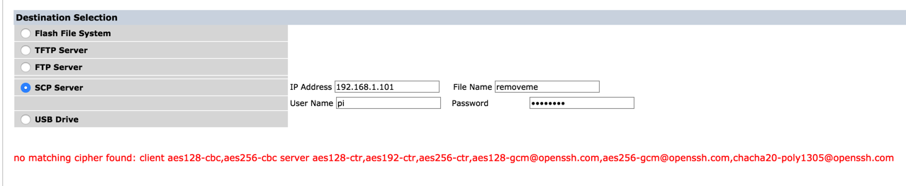

When we attempt to use scp to transfer a file from the mobility controller to ssh server, the following error is seen.
Solution
In order to resolve this, the following change is necessary on the given server to the sshd config.  The following change was applied to a Raspberry Pi, but should be applicable to any linux based server running openssh 6.7 and above.
  • Edit the file as root located at /etc/ssh/sshd_config  --> this may vary depending on your distribution
  • Insert the following line of config in the file and save.
    • Ciphers aes128-cbc,aes256-cbc,aes128-ctr,aes192-ctr,aes256-ctr
  • Restart the sshd service with the following command, service ssh restart or  /etc/init.d/ssh restart  --> this may vary depending on your distribution.
Note:  Ensure that you have console access to server in case of being locked out and needing to roll back the changes.
