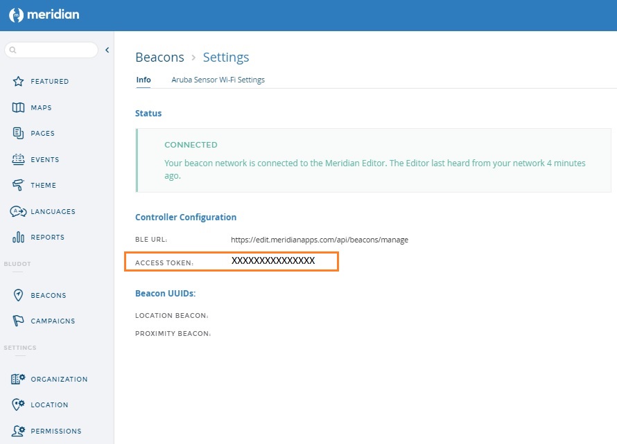

Below parameters needed to be configured in the ap system profile on mobility controller:
  • BLE Endpoint URL
  • BLE Auth Token
  • BLE Operation Mode
BLE Endpoint URL:  This URL points out controller to meridian cloud and helps to resolve the endpoint to form a secure tunnel. This URL is as would be :
 https://edit.meridianapps.com/api/beacons/manage
BLE Auth Token:  This is unique identifier per meridian account and differentiates between customers. This token can be obtained from beacon settings page of meridian account as shown below:
BLE Operation Mode:  This enables the Controller to report Beacons status to the Meridian Editor.  This is set to "Disabled" by default.  Set to "Beaconing".
