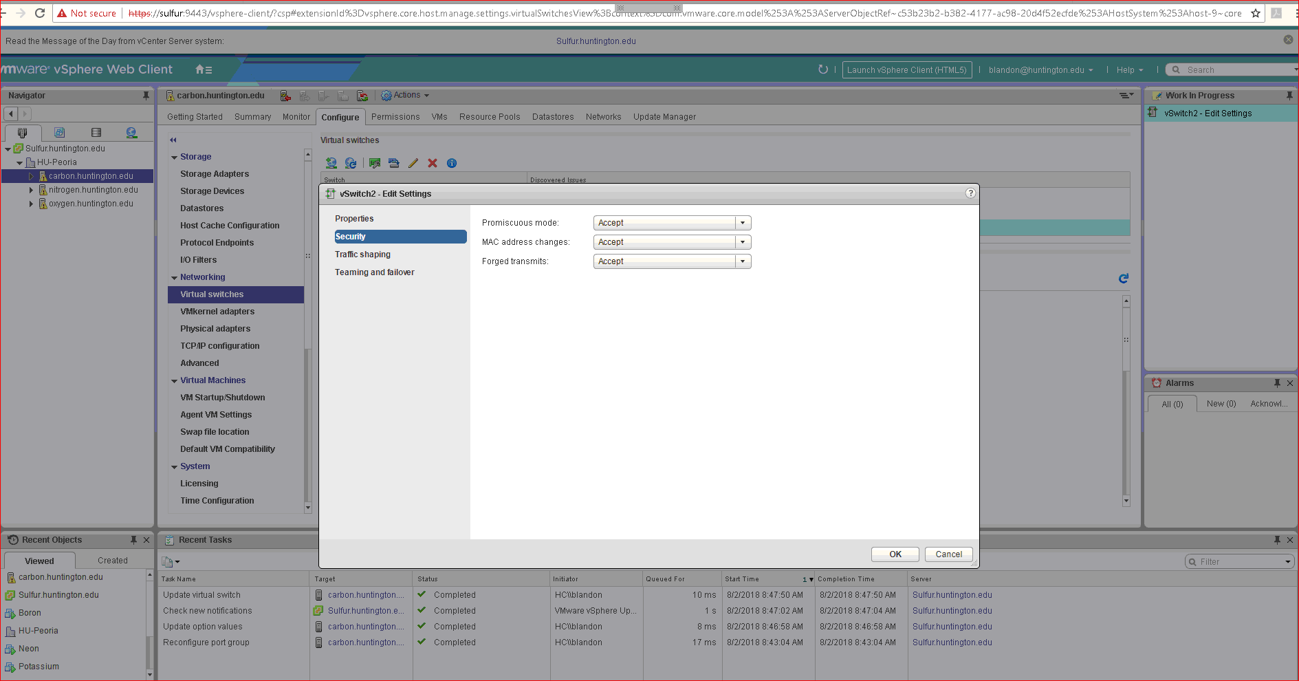

  1. From the Navigator window >Manage>System>Advanced settings
  2. Scroll down or use the search bar to go to the Net.ReversePathFwdCheckPromiscoption
  3. Select Net.ReversePathFwdCheckPromisc and click Edit option
  4. In the Edit option-Net.ReversePathFwdCheckPromiscwindow update the New value field to 1 and click Save
This option makes sure that there are no duplicates packets are being sent back to the Virtual Switch machine.
Once we set the value to 1. We will have to disable and enable the Promiscuous mode on the VM Switch settings to make sure that it takes effect on the VM instance.
Once we enabled it, the clients will be able to get an IP from the network:
