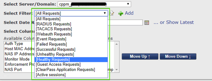

In ClearPass Access Tracker, we have below filters available by default. This article will explain, how to create a custom Access Tracker filter.
To configure additional filters in Access Tracker, we need to create a Data Filter from Monitoring > Data Filter option.

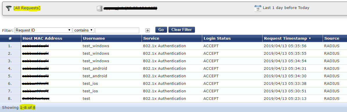

Access Tracker Output with the filter as "[All Request]":
There are 8 requests in the Access Tracker with default filter.
