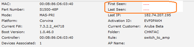

In the screen shot given below, we can see that the switch loses the IP address as we have tried logging in before it gets synced with activate.

In the screenshot shown below, we can see that the switch tried to contact activate server. Post that, if we login to the switch it will be retaining the Ip address.
