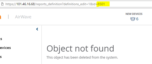

Check the ids under report_definition as shown below to see which one is not returning any result.
Here the id 8501 did not fetch any result.
Solution
Delete the duplicate id (i.e. id that did not return any result) from scheduled_event table using the below command to resolve the issue.
airwave=> delete from scheduled_event where id = 8501;
