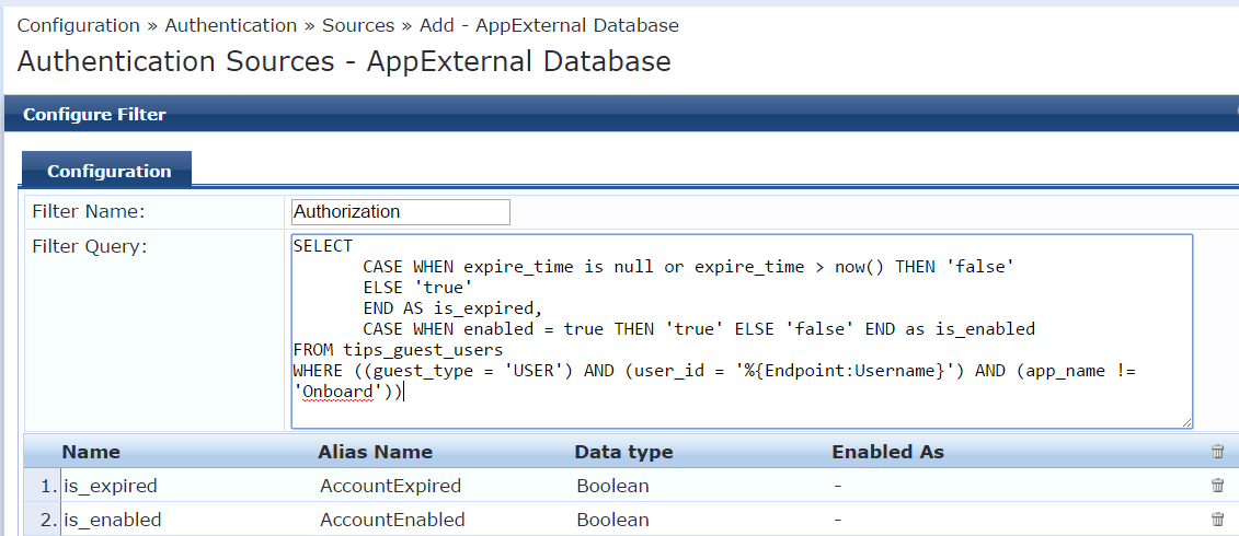

We can also add the filter for authorization similar to [Guest User Repository]
SELECT
       CASE WHEN expire_time is null or expire_time > now() THEN 'false'
       ELSE 'true'
       END AS is_expired,
       CASE WHEN enabled = true THEN 'true' ELSE 'false' END as is_enabled
FROM tips_guest_users
WHERE ((guest_type = 'USER') AND (user_id = '%{Endpoint:Username}') AND (app_name != 'Onboard'))
and attributes is_expired, is_enabled as Boolean.

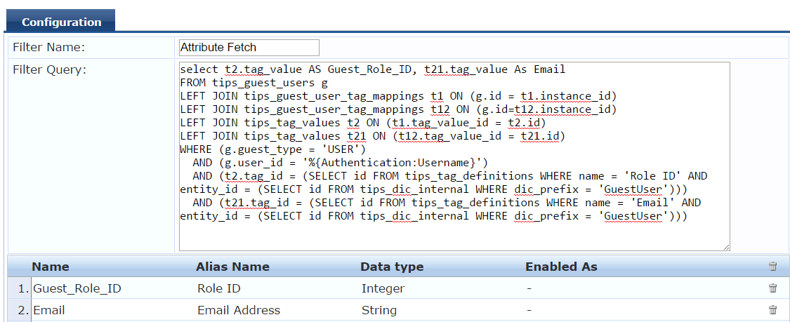

We need to add a custom SQL query for fetching Role attributes and Email address if needed, to authorize based on guest account role.
select t2.tag_value AS Guest_Role_ID, t21.tag_value As Email
FROM tips_guest_users g
LEFT JOIN tips_guest_user_tag_mappings t1 ON (g.id = t1.instance_id)
LEFT JOIN tips_guest_user_tag_mappings t12 ON (g.id=t12.instance_id)
LEFT JOIN tips_tag_values t2 ON (t1.tag_value_id = t2.id)
LEFT JOIN tips_tag_values t21 ON (t12.tag_value_id = t21.id)
WHERE (g.guest_type = 'USER')
  AND (g.user_id = '%{Authentication:Username}')
  AND (t2.tag_id = (SELECT id FROM tips_tag_definitions WHERE name = 'Role ID' AND entity_id = (SELECT id FROM tips_dic_internal WHERE dic_prefix = 'GuestUser')))
  AND (t21.tag_id = (SELECT id FROM tips_tag_definitions WHERE name = 'Email' AND entity_id = (SELECT id FROM tips_dic_internal WHERE dic_prefix = 'GuestUser')))
The Guest_Role_ID and Email are being fetched using the above SQL query which can be used as Authorization attributes in our enforcement. We need to create the attributes  Guest_Role_ID, Email as shown in the screenshot below

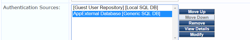

Once this is done map the created authentication source in the respective service.

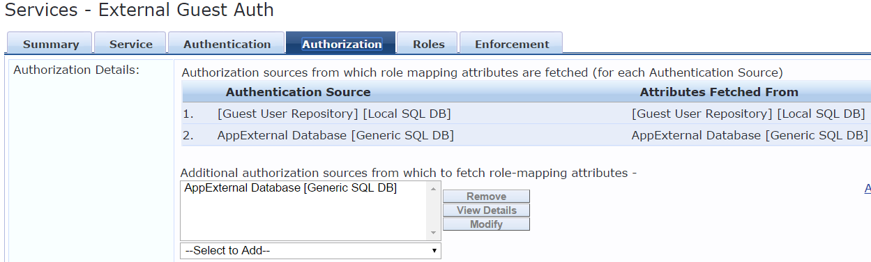

We can also enable authorization on the service and add the external source created as an authorization source also.
After all this is done you should be able to authenticate guest users from one ClearPass server on the other ClearPass server and assign them different roles based on their guest account's role id.
