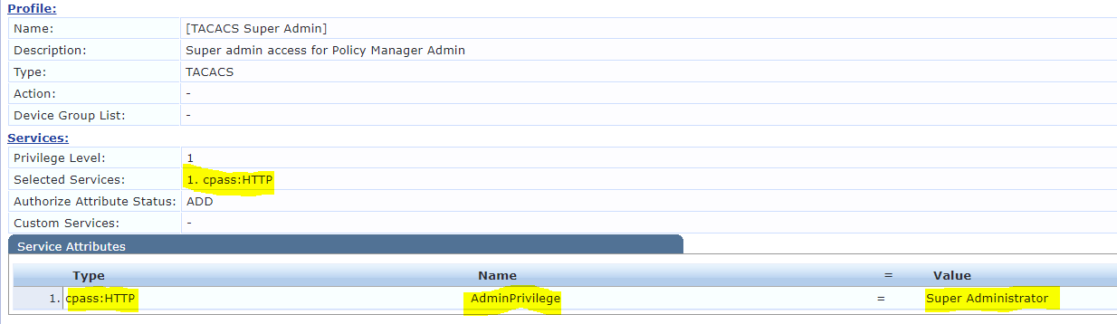

On the external TACACS server [ClearPass], I had created a service which will return back cpass:HTTP > AdminPrivilege = Super Administrator upon authentication as shown below:
Similarly we could return TACACS Help Desk, TACACS Network Admin, TACACS Read-Only etc. as required.
Please Note : Even if you are using any other external TACACS server, ClearPass expects the above mentioned attribute to allow the users to login

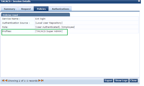

Once you have configured, please try logging into the ClearPass server. You can see a TACACS request initiated to the remote server IP and in our case here we can see a request on the external ClearPass server.
Note- Important: Even if we specify the external TACACS server for management authentication, ClearPass always checks its own Admin repository first when a management login is attempted. Only if the user failed to look up in the local Admin database a TACACS request is initiated to external server. This will make sure users can still login to GUI in case if external TACACS server goes down.
