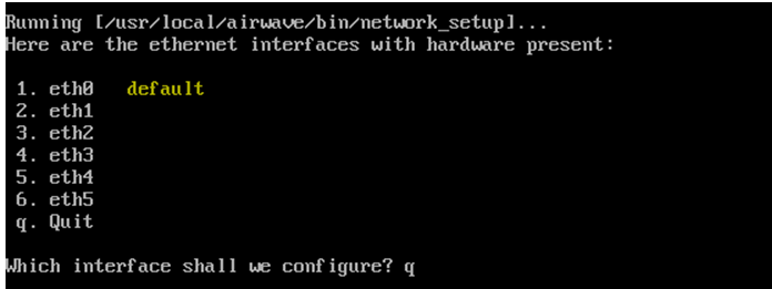

While executing #ifconfig from the AMPCLI, we can see a different Ethernet port's Hardware MAC address would be assigned.
If we can get to the linux rescue mode, we still would not be able see the Hardware mac assigned to each of the Ethernet interfaces unless we configure every interface.
Solution
Below are the Interface-to-Hardware MAC address mapping:
Eth0 – port A3
Eth1 – port A4
Eth2 – port A1
Eth3 – port A2
You would be provided with the below option to chose the appropriate interface:
If  LAN cable connected to Port A3, then Eth0 should be configured while fresh installing during CentOS migration.
If LAN cable connected to Port A1, then Eth2 should be configured while fresh installing during CentOS migration.
Also set the interface you configure as the default interface.
Later you can change the ap_facing_amp_interface at the seas_config table.
