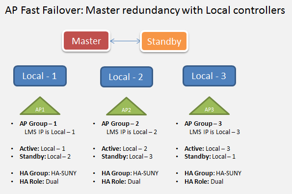

The HA roles supported are active, standby and dual. The solution template will build one HA group for a set of controllers deployed in an active / active model

  • When HA roles of the controllers are set to dual, the active controller will be determine by the LMS-IP setting in the AP system profile and the standby controller will be selected from the list of controllers listed in the HA group in the round-robin fashion.
  • Multiple HA Groups can be defined but each controller can only be assigned to a single HA group.

Sample Lab Topology
