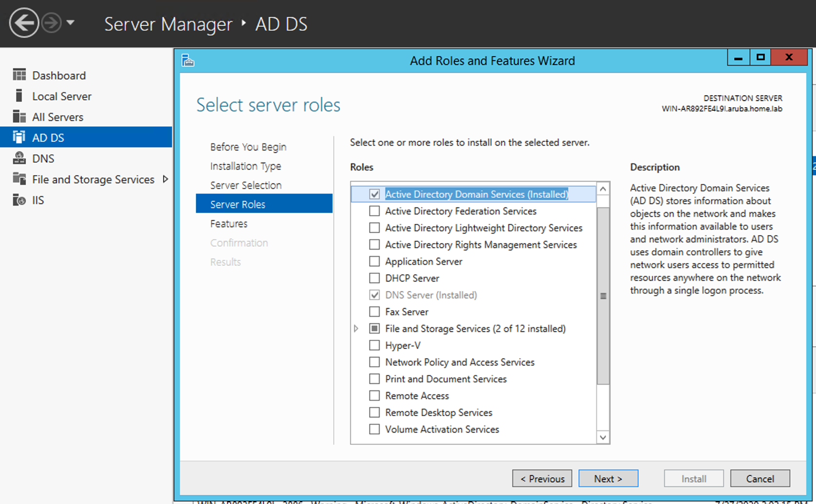

Setting up Windows Server 2012
1. Make Domain Services are installed and is a part of a Forest

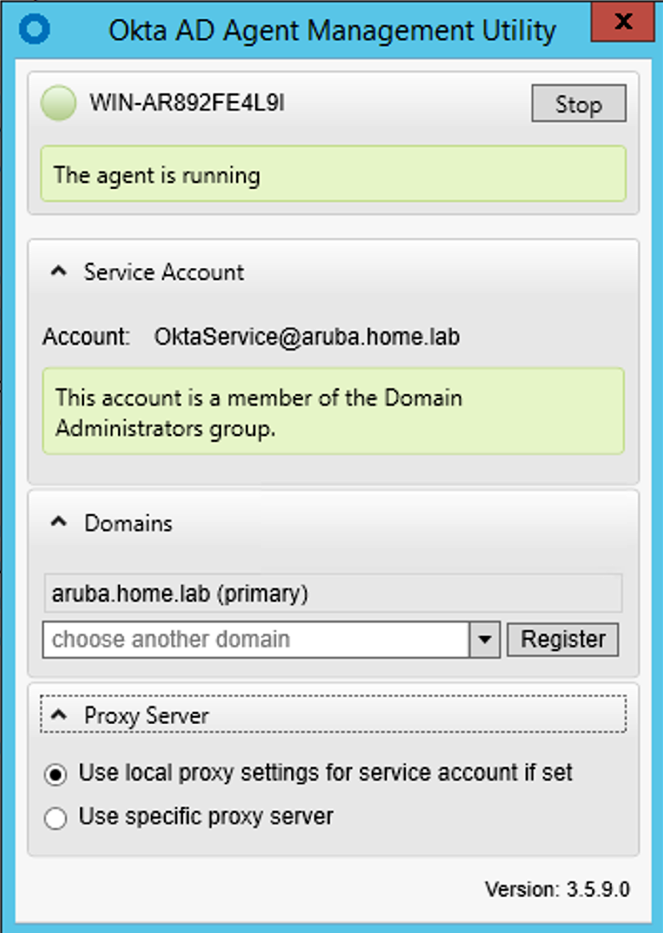

Installing Okta Radius AD Agent Manager
1. Install the AD agent application downloaded earlier
2. You can ignore the proxy settings ( to communicate with Okta Cloud from DC )
depending on the environment
3. Select a domain to register the Okta AD agent with Okta. To register the Okta AD
agent with the Okta service, enter your Okta subdomain name. This is the hpesandeep
part of the example: hpe-sandeep.okta.com.
4. Okta will prompt for the Okta login once domain is selected.
5. Click on ‘Allow Access’ for the permissions on final page.
6. Once installation is completed, make sure Okta Service account is created under the User directory
7. Post Installation run the Okta AD Agent Management and confirm the service status

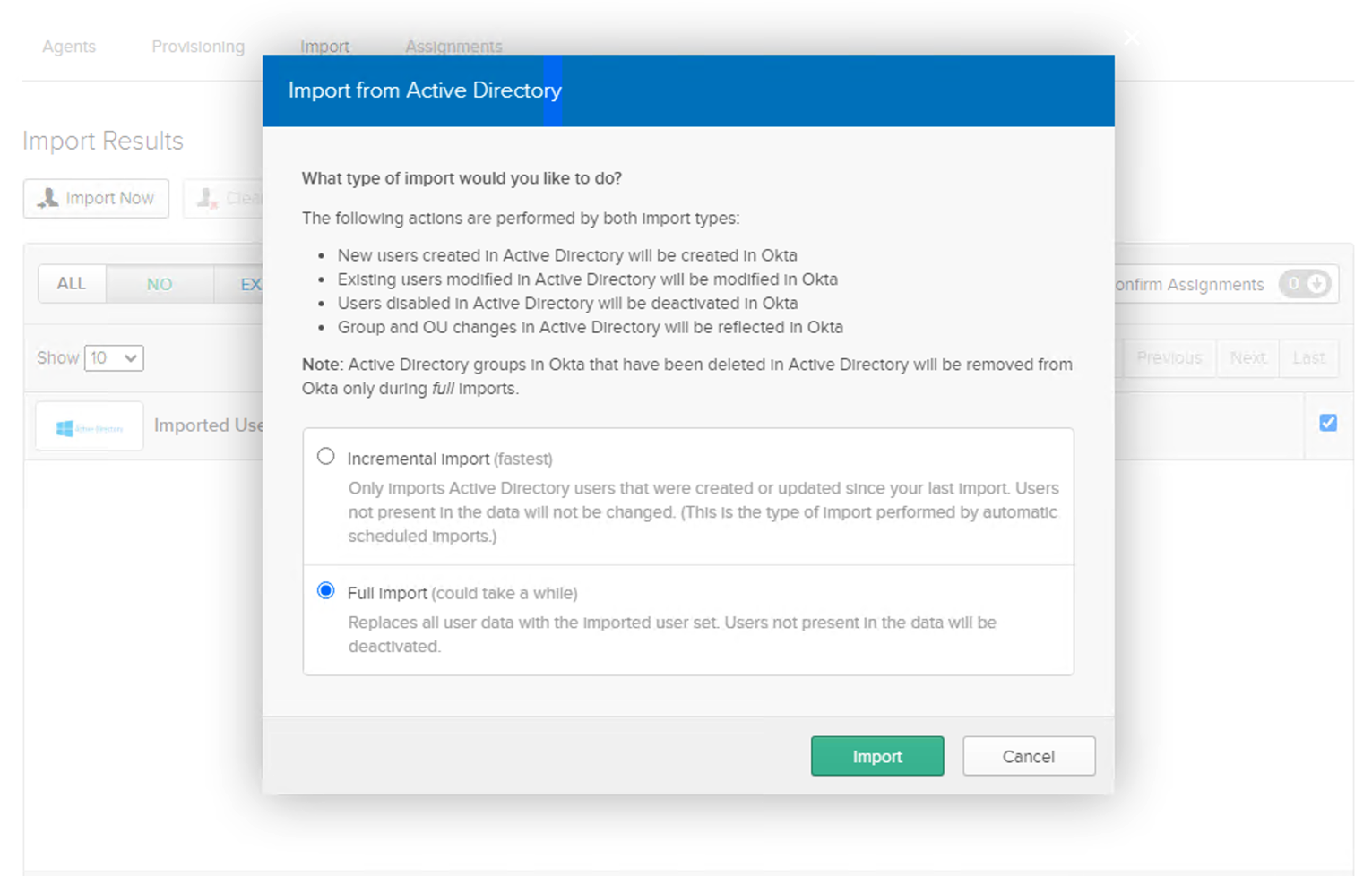

Provisioning AD on Okta for importing User and Groups
• Login to the Admin Console, go-to Dashboard and click on aruba.home.lab
• Select the User OUs and Group OUs you would like import
• Navigate to Import tab, and click on Import Now.
• Choose Full Import (If importing it for the first time, and could use Incremental
for subsequent import to import the recently added accounts or groups)
• Auto-import option is available to import at schedule time.

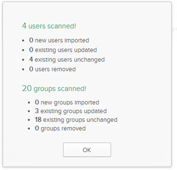

• Once imported you will see the changes with the no of users and groups imported
• Confirm the groups and users imported by navigating to Directory > People or Groups

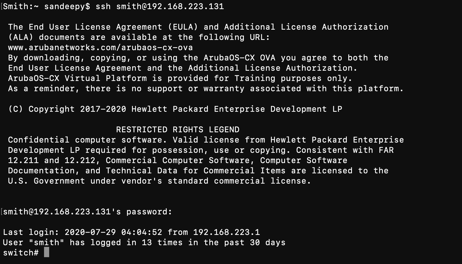

Setting Aruba OS-CX for TACACS
• Configure the switch pointing towards CPPM for TACACS and enable TACACS for SSH
• Here I am using vrf mgmt. as I don’t have l3 vlan configured on switch ( config. would be different on network to network)
SSH to Switch using your AD account:
Username: smith (oktausername prefix you can set it to anything once accounts are imported – not referring to actual SamAccount or UPN )
Password: {Password},push
Always use ‘,’ after password and specify the 2F method like ,push or ,call or token ( you can get the token from the app )
Once, you enter the password accept the push notification on the phone application:

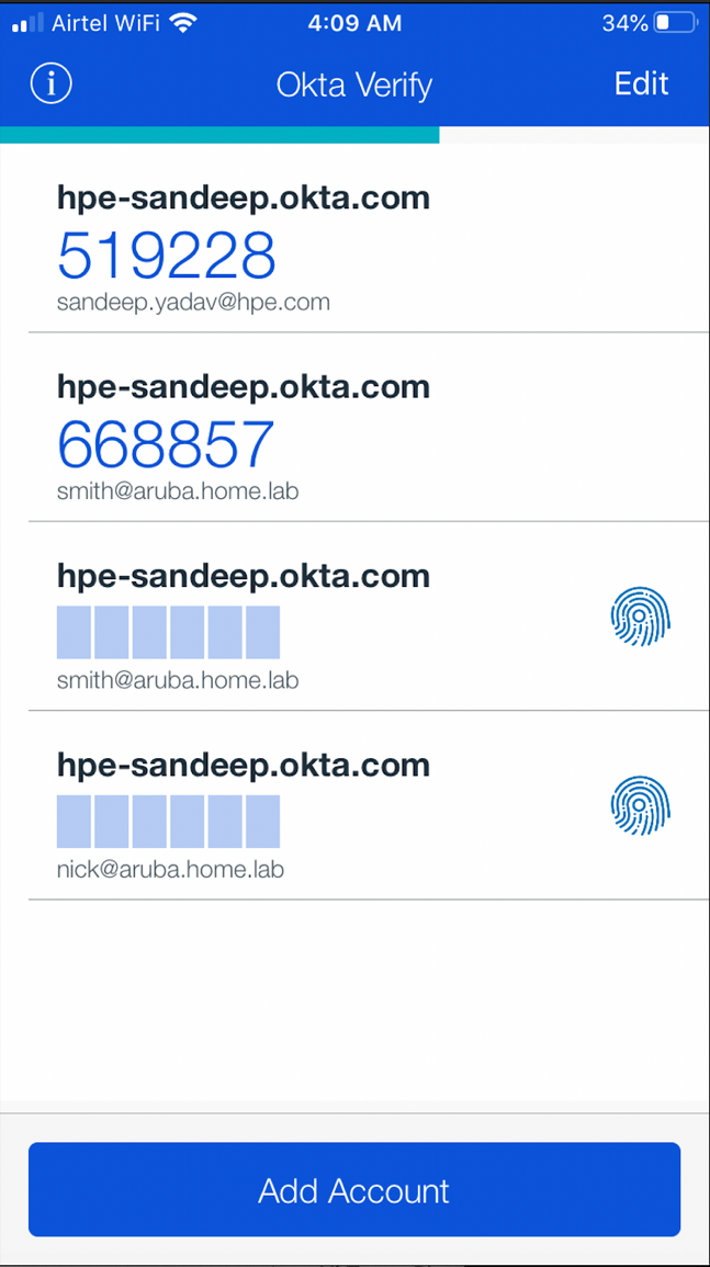

Enrolling your device for MFA
• Download the Okta Verify application from App store or Play store.
• Navigate to organization URL, in our case https://hpe-sandeep.okta.com
• Login with your AD credentials, based on the Factor Enrollment Policy it will load the QR code to be scanned on device via Application
• Once device is enrolled open the app and confirm you have both tokens based and Push notification-based accounts mapped
