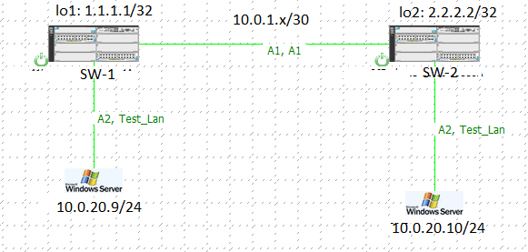

Topology:
Devices Used:
2 x 5412R switches : Version - KB.16.08.0001
2 x Servers
The Clients connected to vlan 20 on both the switches need to communicate with each other,the switches are connected through a /30 network between them and no gateway is configured on the Servers.
The overlay network will be Vlan 20 and underlay is the vlan 1

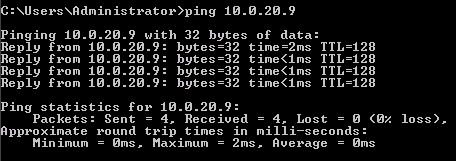

Server Ping results from 10.0.20.10:
