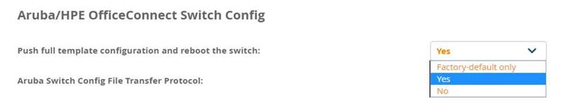

However, when we navigate to the Group's basic page of this switch on Airwave, we could see the following:
If we see the above configuration, we will only push the full template configuration and reboot the switch, only when the switch is in factory default state. If the switch is not in factory default state, we will not push the configuration.
Solution
We will need to change the option to Yes, which will enable Airwave to push the configuration and also execute reboot command on the switch, as Airwave will use full config mode.
If we do not wish to reboot the switch, However, push the partial configuration, we could select No and use Partial config push option from the Group --> Template page for the device.
