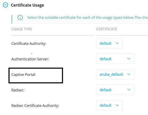

  1. Certificate mapped under Security settings.
Captive portal cert on new accounts will be : aruba_default.
In case customer is using their own certificate for CP, then the mapping should point to their certificate.
We can run the following command on IAP:
IAP# show captive-portal-domains
Internal Captive Portal Domain:
securelogin.hpe.com
External Captive Portal Domains:
asw1.cloudguest.central.arubanetworks.com
The CP domain should be the CN of the certificate mapped under the security settings. There are cases in which customer are changing the setting & pointing it to default certs which causing issues with cloud guest Authentication.

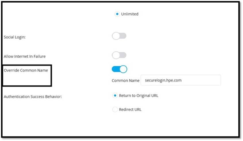

3. There is a Common Name override present in splash page profile.
Please ensure that is not changed to a different CN. It should be same as CN of certificate mapped to Captive portal profile under Security settings.
In this case I am using aruba_default certificate, so the override is pointing to “securelogin.hpe.com”.
