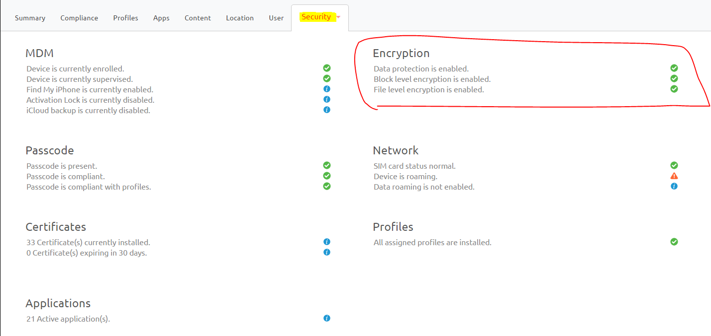

Below is an example of a client which shows the encryption is enabled which is one of the security attributes in AirWatch.
However, in ClearPass when we compared the security attribute for the client in ClearPass 6.5.x and ClearPass 6.6.5, we see a mismatch in value for attribute : Encryption Enabled which is a security attribute in AirWatch.

As seen from the screenshot seen in AirWatch, we see under the security tab, that encryption is enabled. We see a mismatch in ClearPass 6.6.5 for this value whereas we see the correct value for attribute :Encryption Enabled in 6.5.7
