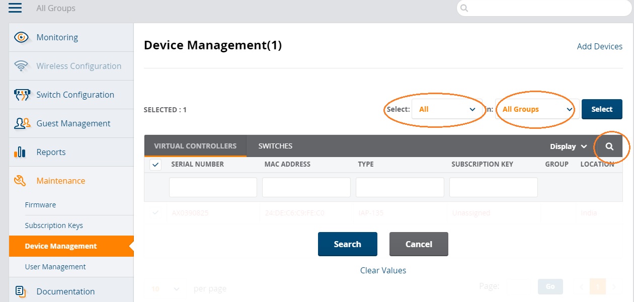

1. Once you login to Aruba Central, click on "All Groups" and move on to 'Device Management" under Maintenance.
2. In the right-pane, you would be presented with the list of IAPs.
3. Now , click on the "Search tool" and it pulls down the fields to enter the search text.
(NOTE: Make sure you have selected ALL in the above drop down. This helps central to search among all IAPs irrespective of group and license assignment.)
4. Enter the Serial Number or MAC address of the IAP or Switch and hit "Search"

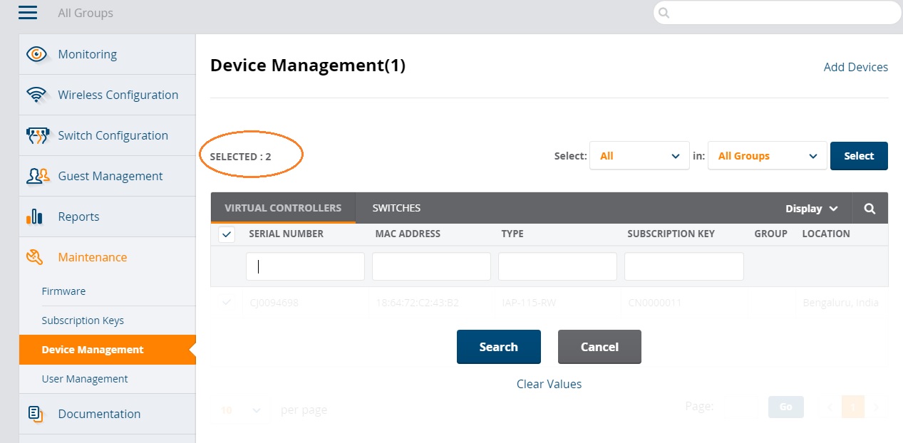

5. Here is where the intelligence of Aruba Central comes to play.
From  the search result select the IAPs and Central would remember your selected IAPs, even if you change the search string and initiate an other search.
6. Once you finish searching all IAPs that you want to, you can click "Assign License" button in the lower left-corner and move on assigning the licenses to the selected IAPs
