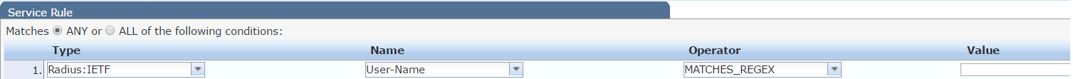

As discussed we need to configure a service with the service rule as shown below along with your other service conditions
Once that's done all the users authenticating from "domain.com" domain only would be handled by this service. For other domains also we can configure the services by putting in the appropriate regular expression.
