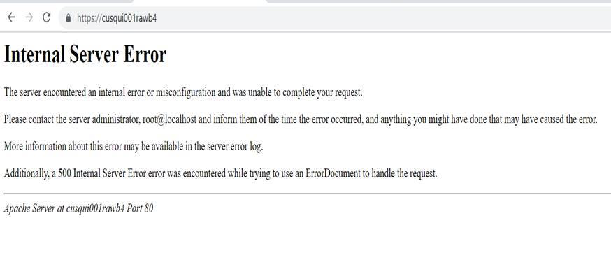

Problem:
Server GUI not accessible due to file corruption
Diagnostics:

If we try to access any logs or try initiating reboot from CLI we will be getting "bash permission denied" message.
Solution
The above errors and symptoms shows the file system on the server is corrupted. We can fix this by unmounting the partition and doing a power cycle for the server. For unmount you can follow the below command,
