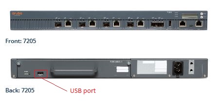

Note:
All the models of 70xx and 72xx has only USB port either in the front or rear panel. But 7205 controller has two USB ports one in front and another one in rear end. We recommend to use rear end panel of the 7205 controller for USB code upgrade.
