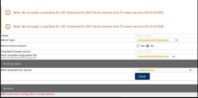

After adding the HP switch 3810 the configuration state in Airwave will show as error even though we have the SSH timeout set to 120 and updated the right SSH credentials.
1.  From group -> template page we will see the following message that No template is available,

Here the issue is with the ‘blank space’ character in hostname which is not expected by Airwave. As a result the command prompt string matching fails , thereby causing command timeout.
As per the RFC952 (https://tools.ietf.org/html/rfc952) , space is not permitted as part of host name. This may require a change at the switch side to prevent using space while creating hostname.
