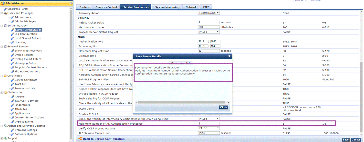

Navigate to Administration >> Server Manager >> Server Configuration and Click on the server and Select RADIUS server under Service parameters and change the setting as below
This setting need to be configured on each server in the cluster if required.
NOTE: This should only be changed in coordination with Aruba TAC.
