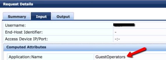

The Application:Name in the incoming authentication request for Guest SSO requests
The Application:Name in the incoming authentication request for Operator login SSO
As we can see the attribute for Service Categorization between operator login sso requests and guest web login sso requests is different.
We need to make sure that we modify our services to handle both these requests if we have SSO enabled for both Operator login and Guest Web Login so that everything starts working.
