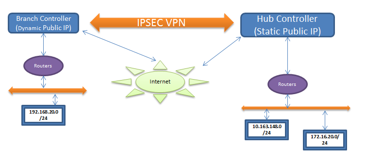

Lab Topology
Configuration Notes
In most deployment, the Mobility Controller (MC) are likely installed behind firewalls and Intrusion Detection or Protection devices. The policy on these devices should allow UDP 4500 to pass through as this is required for the VPN traffic.
