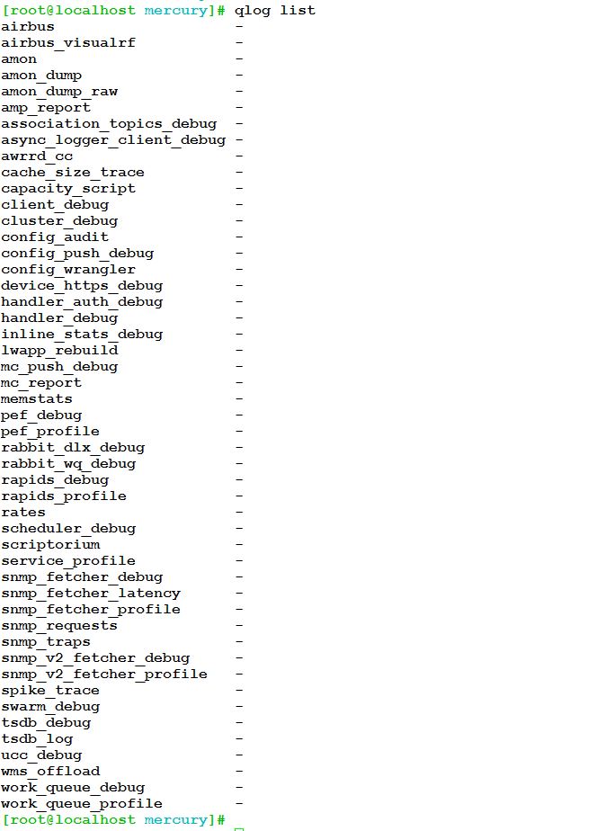

  2. At the prompt, execute “qlog list” command. This command will show all the debug logs that are available.

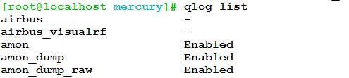

In relation to AMON, we see  three processes.  i.e  amon, amon_dump, and amon_dump_raw.
3. Run the command “qlog enable amon amon_dump amon_dump_raw”  to enable these three amon related debugging.
4.  Run the “qlog list” command again to see which debugging is enabled.
