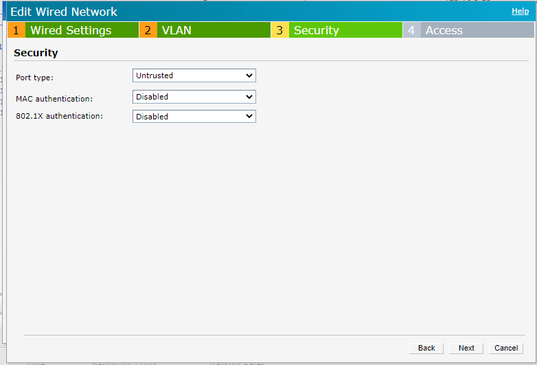

  • 3.  RE: Clients attached to AP-303HR being assigned IP from VC DHCP server instead of domain's
    Posted Nov 11, 2021 03:18 PM
    We are using the default with primary usage = Employee and client IP assignment = Network assigned.  Would I have to setup a VLAN assignment rule?  Would port type under Security need to be Trusted?

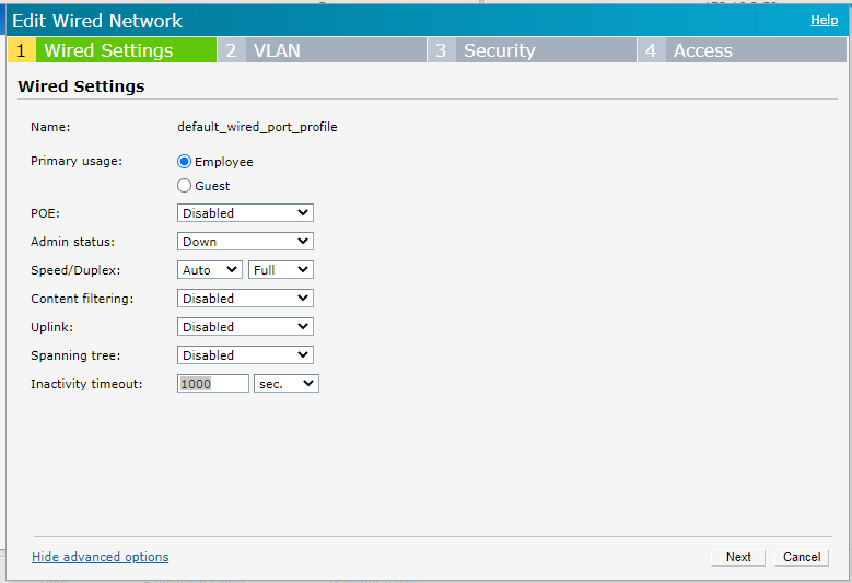

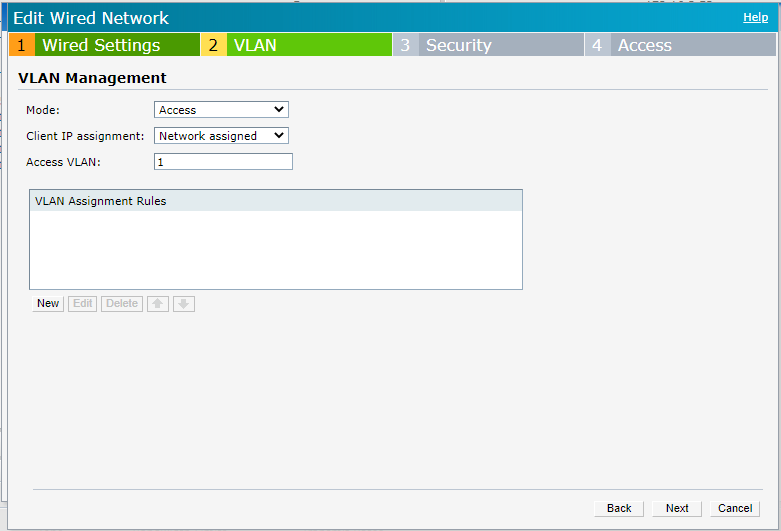

  • 5.  RE: Clients attached to AP-303HR being assigned IP from VC DHCP server instead of domain's
    Posted Nov 11, 2021 04:06 PM
    OK.  I set the Mode to Access.  The client is still getting an IP from the VC DHCP server.  Here are my settings;

  • 6.  RE: Clients attached to AP-303HR being assigned IP from VC DHCP server instead of domain's
    EMPLOYEE
    Posted Nov 11, 2021 08:38 PM
    you need the VLAN ID of the wired setting for his AP to be same as that of your regular corporate SSID.
    i am assuming the regular SSID is not on VLAN 1 right?
  • 7.  RE: Clients attached to AP-303HR being assigned IP from VC DHCP server instead of domain's
    EMPLOYEE
    Posted Nov 12, 2021 09:32 AM
    Afaik, VLAN 1 refers to the native vlan on the uplink of the AP. It is best-practice to separate your client traffic in one or more tagged VLANs. Do you have the settings for your SSID the same? If you have there Network Assigned + a VLAN ID, try to set the same on the wired network profile.
    As this may be hard to troubleshoot in a forum, I would suggest that you reach our to your Aruba partner or Aruba TAC to troubleshoot live what is going on.
