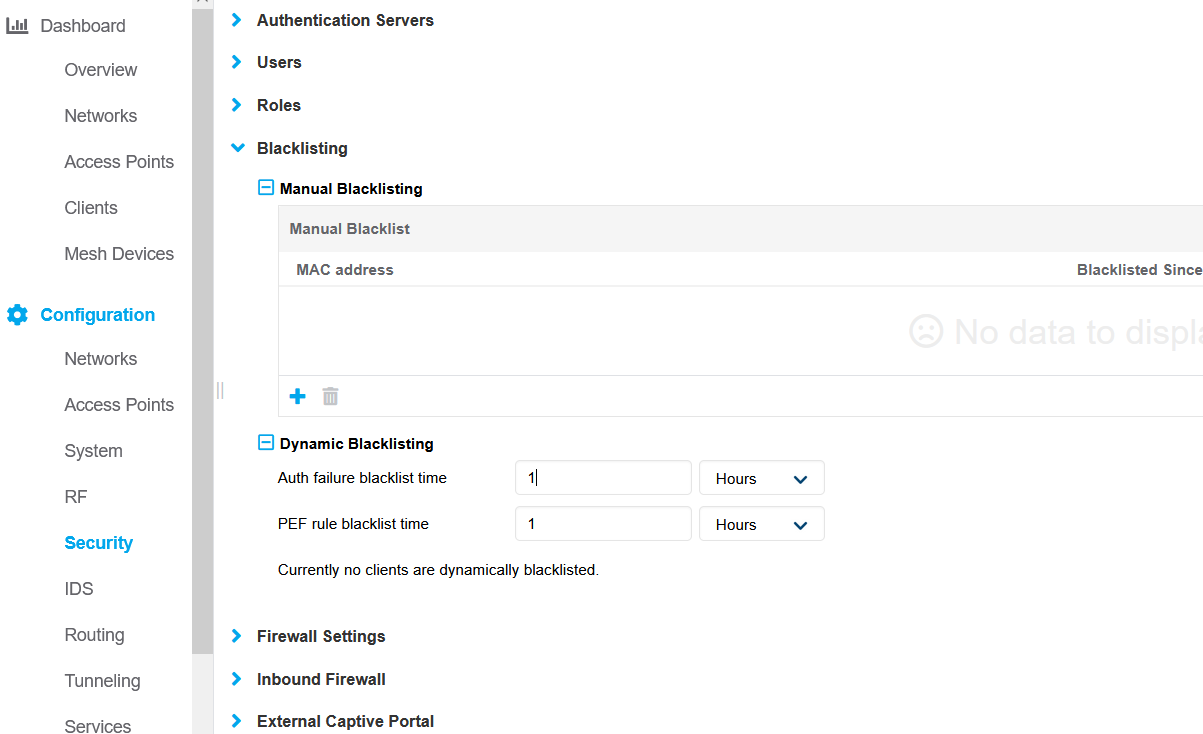

    According to the help context in Central, we can block a wireless client only if "client blocking option is enabled for the SSID under the AP configuration".
    Denylisting Instant AP Clients
    I cannot find this option on the SSID. I believe it is refering to the "Denylisting" option under the Security Tab of the SSID.
    With Denylisting enabled, I am still not able to Block a Client. When I select a client and look at the  Actions field on a Client my only option is to 'Disconnect', not Block.
    Anyone have recommendations to get Client Blocking working?
    Thanks!
    Philip Wightman, ACEX (AMFX) #69. Aruba Partner Ambassador
  • 2.  RE: IAP - Blocking a wireless client
    Posted Jun 16, 2021 07:58 PM
    the use case for denylisting (blacklisting) under security tab, is to enable dynamic blacklisting of the clients with a specific number of authentication failures.
    for manual blacklisting, you can do it from here.
