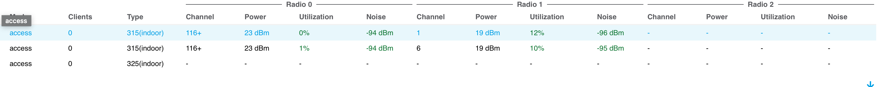

    Hi,
    Is it known issue that mixing IAP315 and IAP325 does not work very well?
    Using version 8.7.2.1 (and also previous version) IAP325's radios will be offline while IAP315's radios works just fine (see image below) 315 is master.
    Also if I try to configure iap325 virtual controllers webUI freezes and I have to reload web page to "restart" WebUI.
    If I boot only 325 in network iap will show up initial "SetMeUp..." ssid so it seems that ap itself and radios are fine and there is something else wrong. I have factory resetted iap325 few times but no luck... If I try to access ap via ssh console, I get "Internal Error" message while trying to login to ap when it is part of virtual controller but when resetted, I can login to it with default uname/passwd
    Any idea how to to proceed with this one?

    Sounds to me like the 315 and 325 are on different firmware versions. Make sure all are on the same release before joining them together. What is also possible is that you disabled the auto-join in the 315s, if the firmware is already on the same version (same build number).

    Auto-join seems to be enabled and I did fw upgrade to 325 separately because it was in it's original firmware. I can do that again just to make sure it is in same version with 315's..

    I did managed to login to 325 and it was in version 8.7.1.2 like it is in 315's VC at this moment.
    I tried to access webUI while 325 was only ap in network but did not succeed to open up web at all.
    I did "pinhole reset" but SetMeUp-network did not work either. Firmware remained in 8.7.1.2 so seems like I have done upgrade twice already.
    But I still point out that I have two 325 apps which are acting like same so I still do not believe this is caused by broken hardware...

    325's (nor 315's) has not been in used in Aruba Activate or Central.
    Anyway, I kind-of "solve" the problem:
    I changed switch port and by mistake, I added same virtual controller vlan into untagged vlan for new interface and 325 did join existing VC, booted up radios and started to work normally (after I added four additional tagged vlan's to interface hosting ssid's)
    Weird thing was that interface config was 100% same than non-working port, cable was same and only thing was different was interface.
