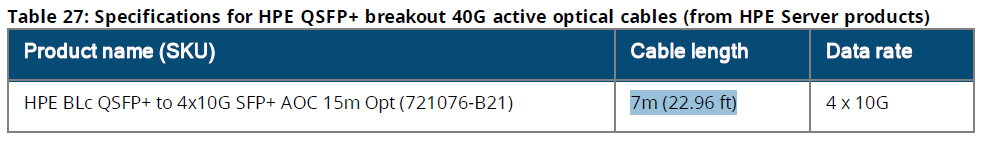

    We currently have a 6 x 5900AF IRF which has a connection to some 6120XG Procurve switches using a 721073-B21 (HP BladeSystem c-Class QSFP+ to 4x10G SFP+ 10 m active optical cable) cable, we would like to re-use these cables on some Aruba 8320s (use the QSFP side of the cable and plug it in the 8320). As per the "AOS-Switch and AOS-CX Transceiver Guide Edition 10" the 721076-B21 breakout AOC is supported but there is no information for 721073-B21, from what I can see the only difference between these two cables is the length ( 721076-B21 is 15m and 721073-B21 is 10m). Any confirmation regarding the use of the 721073-B21 in the 8320 would be highly appreciated.

    It's indeed very strange that HPE Aruba qualified the 15 meters long AOC (721076-B21) only while it didn't for the shorter one (721073-B21)...or, eventually, they just forgot to mention that the short one is supported too.
    To be noted: a typo on the reported cable length (10th edition) exactly for the 721076-B21 breakout AOC...
    I can't prove it...but it's totally reasonable that if the 15 meters long works, the same will do the 7 meters long. Or not?
