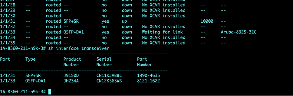

    We have an 8325-32C and an 8360-32Y4C. Trying to connect them via 40G QSFP 1m DAC. On the 8360 we get "Waiting for link error" on the 8325 we get a Module Interface error.
    8360
    1/1/33 -- routed QSFP+DA1 yes down Waiting for link -- Aruba-8325-32
    8325-32C
    1/1/1 -- routed QSFP+DA1 yes down Module interface error -- --
    This is the DAC part number
    HPE X242 40G QSFP+ to QSFP+ 1m DAC Cable (JH234A)
    We have tried different DACs and have tried to connect from  8325-32C to 8325-32C and we get the same error.
    Both switches have Version : GL.10.07.0020
    We have set the interfaces to speed auto 40G and no auto but still the same result.
    Anyone has seen this "Module Interface error"?

    Thank you for your response. We called TAC and it was a firmware issue. We booted to secondary image 10.06.0110  and link came up. Then upgraded to this version 10.07.0021 and this one worked as well, 10.07.0020 is the one that has issues.

    Yes, the 8325-32C was the one with the issue. We didn't have to upgrade the 8360 and the module error change to Waiting for Link in the 8325 and the link change to UP.
