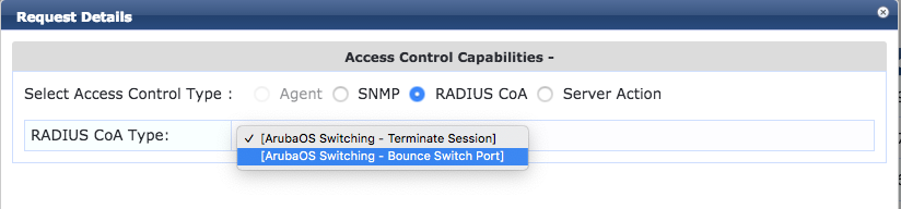

    Can you, from Access Tracker, do a Change Status and you should be able to select CoA and have the ArubaOS Switching actions:
    If you see different actions here, the Vendor is not set to Hewlett Packard Enterprise in the Network Device definition, and also the options you see here are the only ones you can (should) select in the profiler action tab.
    Also, if there is a failure you can see the failure reason when manually triggering the CoA. First make sure that manual CoA is successful, only after that try the automatic response in Profiling.

    Sorry for the slow reply. I think I have the switch and profile tab set correctly but I can't do a CoA from the Change Status page.
    If I go to Change Status from Access Tracker, I only see the following:

    Ok, in that first screenshot of change status you should be able to see the RADIUS CoA option first.
    Have you enabled accounting in your switch? That may be required and you should see the 'Accounting' tab in Access Tracker.
    If you have accounting enabled, and see the Accounting tab in Access Tracker and still don't see RADIUS CoA as an option, can you check if Insight is enabled from the Server Configuration, and enable it if it isn't? I don't think Insight is a requirement, but it's one of the first things I turn on for additional visibility/reporting.
