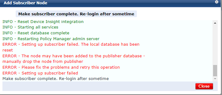

    Trying to rebuild our VMs that are running out of space and originally built with 500gb disks.  So dropped one of the subscribers and created the new vm but now can't make it a subscriber.  Wish there was a way to just add a second 500gb disk and have the OS resize the partitions.
    New VM was built with recommended settings with 6.9 ovf and then updated to 6.9.5 which is what currently is on the publisher.
    I had exported all certs from the old VM (https are signed by commercial CA) and imported them.  Also imported the root and intermediate certs to the Trust List and make sure they are marked as "Others" and enabled as suggested by the field notice for 6.8. Publisher and subscriber are on the same vlan and new VM using same IP address as old one.
    However, make subscriber fails via GUI.  Have not tried via console with -V   Any ideas? Am I missing something?

    Well, interesting that when you install the OVA it gives you an option to encrypt the disk or not. So is it required? How do I know if the existing ones were encrypted? Wonder if I chose not to when I installed it?
    This is what I did which was vetted by our Aruba SE:
    * Drop subscriber from publisher
    * Set up new vm with correct specs with version 6.9.0
    * Add platform license from dropped subscriber and activate it (had to get it converted but worked)
    * Upgraded to 6.9.5 since that's what's on publisher
    * Imported root and intermediate CAs that signed publisher's certs (based on 6.8 technote)

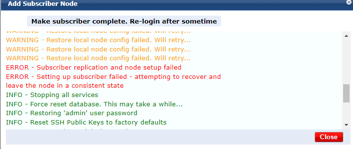

    * Attempted to make subscriber with or without backing up or restoring config options - all failed.
    All reattempts I had to drop the 'in progress' subscriber from the publisher. I have not tried to do it via the command line ignoring the certs but obviously something else going on.
    Goal is then make this new updated subscriber the publisher. Then drop the original one and the other one (we have three total) and add them back to the new publisher. And finally switch back so publisher is the one named "1"

    Tried all of that but still failed.  In the end late in the day I was finally able to get in touch with TAC.
    The problem was with some Root CAs that existed in the new image which had a different expiration date than what the publisher was sending. This is a bug fixed in 6.9.6. Once those were deleted (UserTRUST, Comodo, AAA and AddTrust) it joined the cluster without issues.
