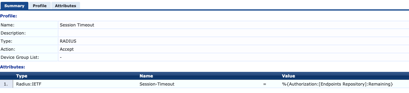

    Create a new filter in Endpoint Repository using the below query:
    select (extract(epoch from(to_timestamp(attributes->>'MAC-Auth Expiry','YYYY-MM-DD HH24:MI:SS'))) - extract(epoch from(now())))::int as Remaining from tips_endpoints where mac_address ='%{Connection:Client-Mac-Address-NoDelim}';
    Then create an enforcement profile for session timeout
    Enable authorization under the service and add Endpoint Repository
    And map to the Service which will return the timeout in seconds

    Amazing! This worked. Thank you Sandeep
