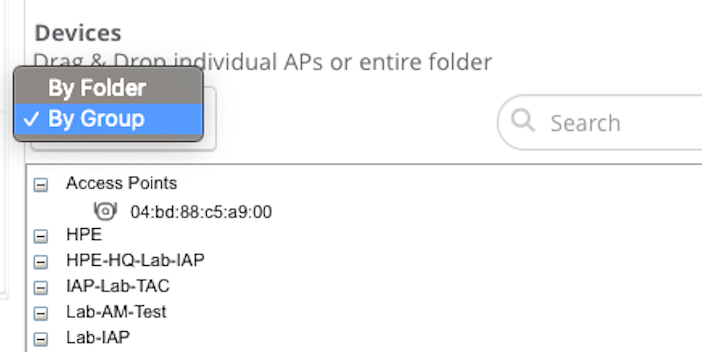

    Yes,
    This is in Airwave, the search box in at the part where you go to place the access points.
    Floor plan -> edit -> Add deployed Devices-> then you get a search box. This is the box i cannot search for folder names inn.

    Yes this is normal. You would search for AP names, not folder names.

    As an alternative we can filter based on folder instead of group under the Add deployed device list.

    Right, but he was asking about typing in the search box to the right. Only the AP names will be searchable in that field.

    Yup you cant search with folder name. Was giving an alternative ;)
