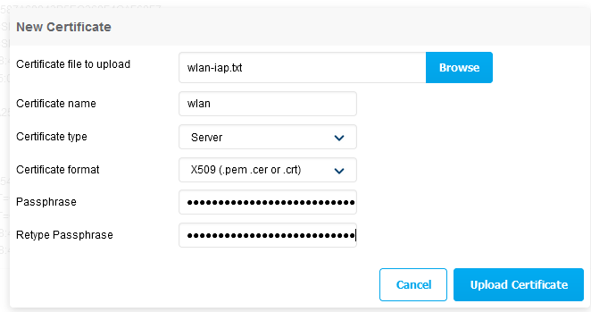

    Hello,
    I'm using Aruba Instant (ArubaOS 8.7.1.2) and trying to renew a server certificate.
    I have a x509 certificate (pem format) and RSA private key (pem). I tried to upload a Server cert by following the manual. But I'm getting an error that says "Convert certificate error".
    Authentication Certificates
    Is there anyone having the same problem? The manual says very little about how to prepare a Server certificate. It only mentions a "Public" certificate, which is apparently a different thing. I guess that I'm supposed to concatenate the certificate pem and private key pem into one text file and upload it? I tried various combinations, double checked if my passphrase is correct, etc. with no luck.
    I'd appreciate if anyone gives me a right direction.
    Thank you very much,
    Yusuke
    Certificate Upload screen:

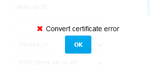

    Error message:

    Please try to rename the certificate to .pem extension and make sure it is built up like:
    -----BEGIN PRIVATE KEY-----
    MIIEvwIBADANBgkqhkiG9w0BAQEFAASCBKkwggSlAgEAAoIBAQDek3ufWnPs690n
    ....  Private key here; can be encrypted as well
    sQ6jaBkawRyMm0qyIT9qaMR5HQ==
    -----END PRIVATE KEY-----
    -----BEGIN CERTIFICATE-----
    MIIGYzCCBUugAwIBAgISBKD2GAkUvLTccjNeGgHCNSRoMA0GCSqGSIb3DQEBCwUA
    ....  Server certificate here
    2Z5sDlTkcQ==
    -----END CERTIFICATE-----
    MIIEZTCCA02gAwIBAgIQQAF1BIMUpMghjISpDBbN3zANBgkqhkiG9w0BAQsFADA/
    ....  Intermediate certificate here
    UdHkhVNcsAKX1H7GNNLOEADksd86wuoXvg==
    -----END CERTIFICATE-----​
    That should work.

    It turned out that the private key I had was in RSA format, as it starts with -----BEGIN RSA PRIVATE KEY----- while
    it had to be in PKCS#8 format. (Your example gave me a clue.)
    I converted the key with the following command:
    $ openssl pkcs8 -topk8 -inform PEM -outform PEM -in rsa.key -out pkcs8.key
    Then concatanate the whole thing:
    $ cat pkcs8.key server.cer intermediate.cer > toupload.cer
    ​Which worked!
    Thanks again.
