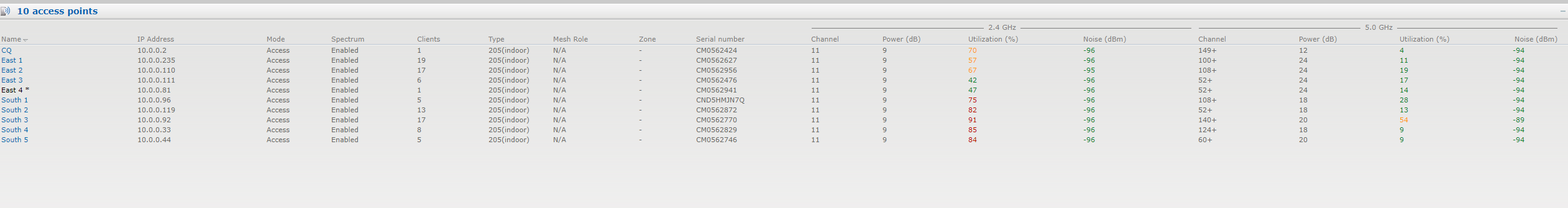

    I recently setup a new network with about 10 APs for about 120 Users. It's been about 2 weeks and I've noticed the network has been having constant issues despite what settings I try to implement. Here's a few things I've noticed:
    Here's the distribution of my APs and their associated powers at peak times. Here it seemed that most users were sticking to the 2.4GHz frequency instead of moving to 5GHz if they could. I tried to solve this by messing with the band-steering and forcing 5GHz instead of Prefer or Automatic, but none of these helped fix this. The power could be another issue if anyone has any suggestions on how to isolate and find a good range for that.

  • 2.  RE: New Setup w/ Packet Loss, High Utilizations and High Retires
    Posted 23 days ago
    Looks like all of the 2.4 radios are on channel 11. Do you only have channel 11 set as an option in your RF/ARM profiles? Are they hard set to 11? If so why?

  • 3.  RE: New Setup w/ Packet Loss, High Utilizations and High Retires
    Posted 22 days ago
    The RF/ARM has a custom range of Radio of 9-15  for the 2.4 GHz and an ARM at 18-24, but the individual APs have adaptive radio management setting assigned so it automatically decided to jump to Channel 11 at 9 dB.
    Fardeen Bhimani

    In your regulatory domain, make sure you have channels 1, 6, and 11 selected.  No other channels below 12 should be selected besides those 3, for now.

  • 8.  RE: New Setup w/ Packet Loss, High Utilizations and High Retires
    Posted 21 days ago
    Alright, so I see the Valid 2.4 GHz Channels set to 11 and I just added 1 and 6 to it... not sure why it was only set to 11, must have been a previous admin. So now its:
    Valid 2.4 GHz Channels: 1, 6, 11.
    As for the neighboring networks, there's only one other network but they don't have as many APs or network traffic going through this part of their network.
    I'll do a restart of the network tonight so that the APs get a chance to switch to their desired channels and powers and send the results!

  • 9.  RE: New Setup w/ Packet Loss, High Utilizations and High Retires
    Posted 20 days ago
    Alright, here's the updated channels, powers, and utlizations %s.
    Things seemed to have move, which is good, but there still a packet loss issue.
