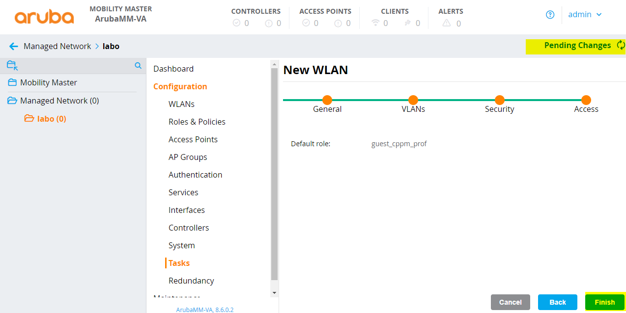

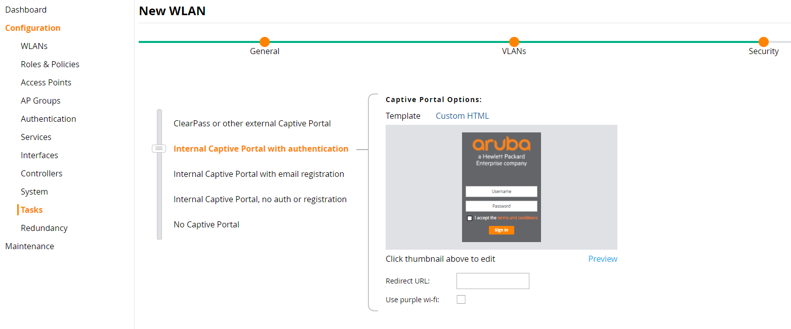

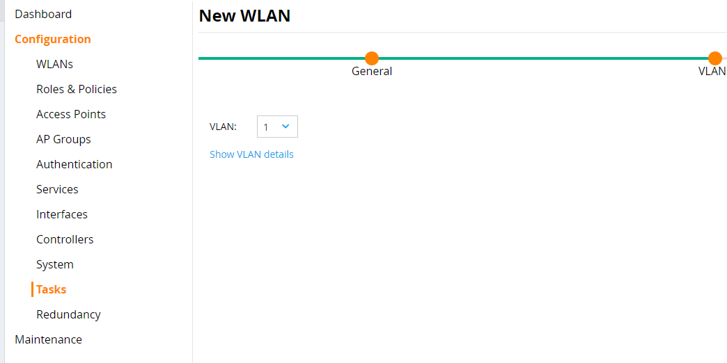

    If you just want the damn portal config, see below. My lab currently has no controllers hence the (0).
    To configure the users:

    The VLAN you use must have a dhcp server and the controller must have an ip address on that VLAN to bring up the captive portal.
