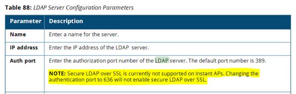

    Hi Ken,
    By re-read your post i see you like to use a certificate for LDAP, probably for secure LDAP over SSL on port 636. Based on this case i was testing this for you in my homelab. LDAP (389) works but LDAP over SSL was not working for me (with imported the needed ca-cert). End-up with the Aruba Instant 8.7.0.x User Guide where is noted that LDAP over SSL is currently not supported on Aruba Instant.
    https://support.hpe.com/hpesc/public/docDisplay?docId=a00101274en_us
    (page 233)
    Where do you like to use LDAP for? As authentication source in your instant virtual clusters or for login at the management page of Airwave? You could also consider TACACS or RADIUS as beter alternative.
