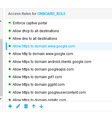

    I think your issue is that you are looking at the policy and you are assuming that the enforce captive portal will happen first as it is listed as the first entry (something like the below) ... However, if you add rules to enable http / https to particular destinations that you need in your role, they will be whitelisted. For example, in the below role, users will be able to access www.google.com even though you have enforce captive portal showing as first entry.

    I have tried that in the past, but using  the default allow any/any rule.  This morning in the default role (RSU1-Auth) I removed the allow any/any and added the below entries:
    When I run show datapath acl 140 for the default role (RSU1-Auth) I see that in theory I should have access to the comodo, sectigo and usertrust sites, but I do not see any hits on these sites.
    and when the captive portal pops up it is untrusted.
