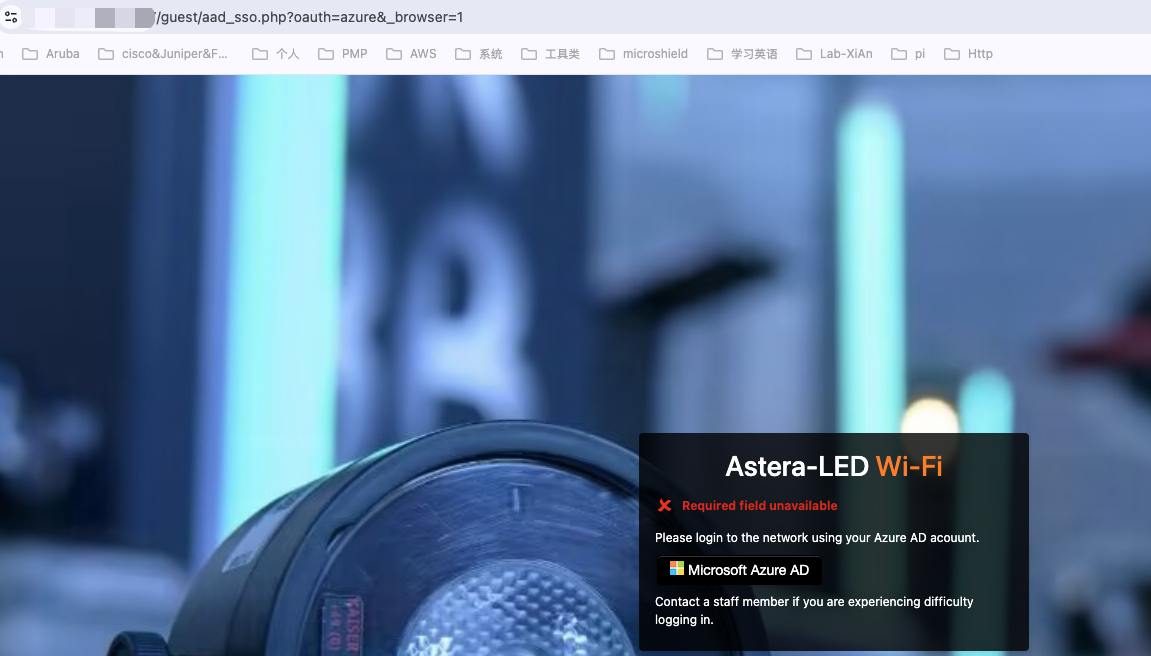

         Currently it is connected to Azure AD and uses SSO to perform PAP authentication:
    https://xxxx:8887/guest/aad_sso.php?oauth=azure&_browser=1

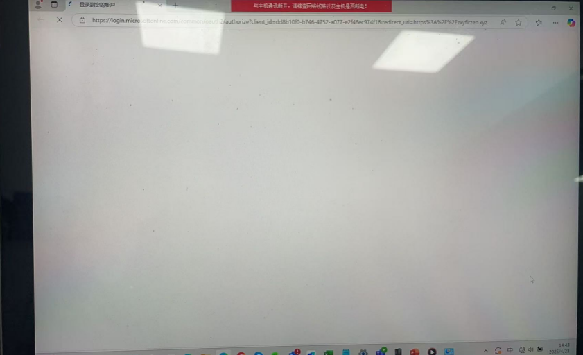

         During the redirection process, the Edge browser will get stuck at this URL:
    https://login.microsoftonline.com/common/oauth2/authorize?client_id=dd8b10f0-b746-4752-a077-e2f46ec974f1&redirect_uri=https%3A%2F%2Fzxyfirzen.xyz%3A8887%2Fguest%2Fweblogin.php&scope=&state=1744871138-50dc9f&response_type=code&resource=https://graph.microsoft.com
