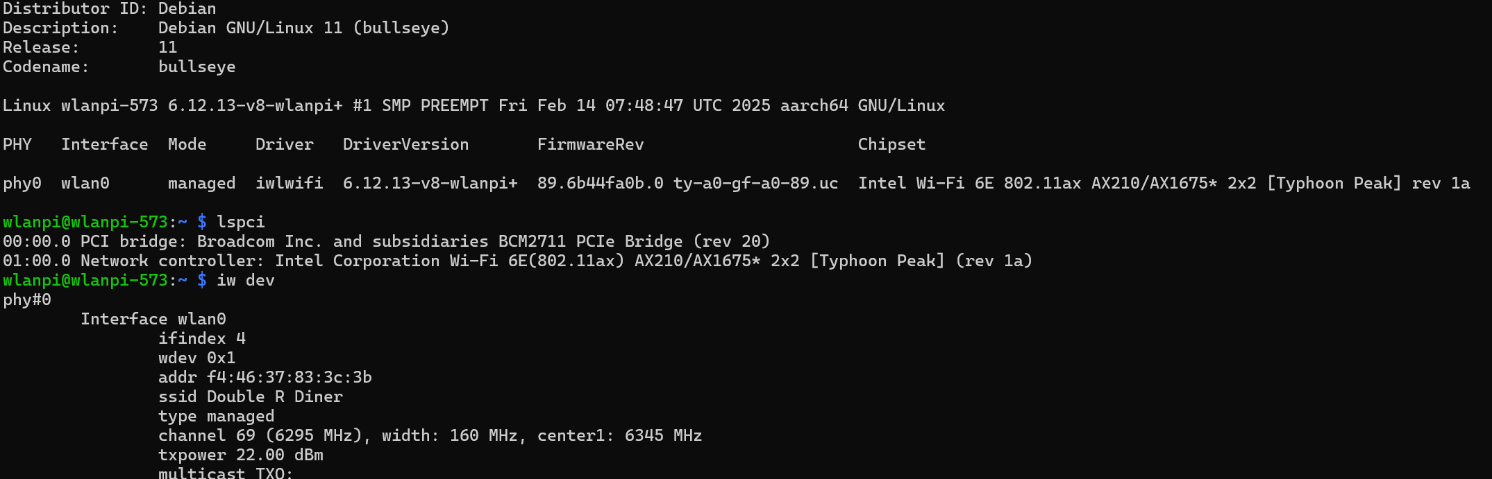

    Indeed. I decided to get access to the 802.11ax-2023 specification myself, and it does indeed say that for 160MHz operation, CCFS1 must be larger than 0 and the absolute difference between CCFS0 and CCFS1 must be exactly 8. Which does indeed mean that at least this part is correct.
    Thank you for saying that they were incorrect about this part.

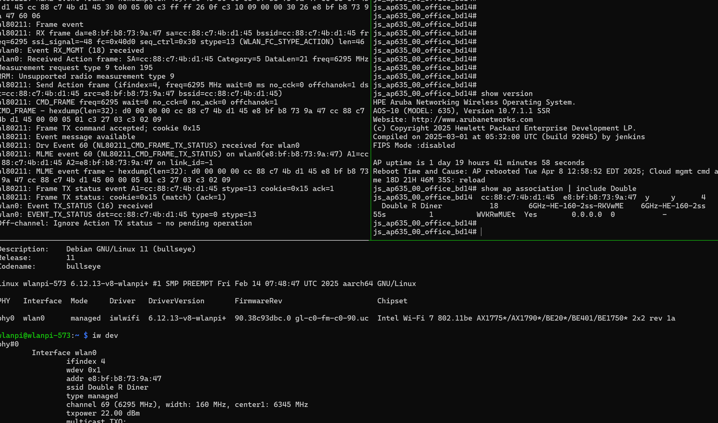

    I also just checked an Intel BE200 on Linux and the Intel client connects just fine to 160 MHz at channel 69 in 6 GHz.
  • 17.  RE: AP-655 6GHz / 6E incompatibility with Intel AX210
    Posted Apr 10, 2025 08:57 AM
    Intel AX210 also works fine...
