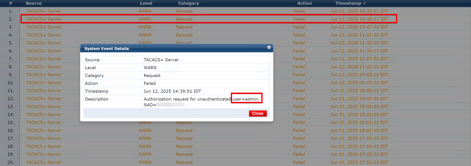

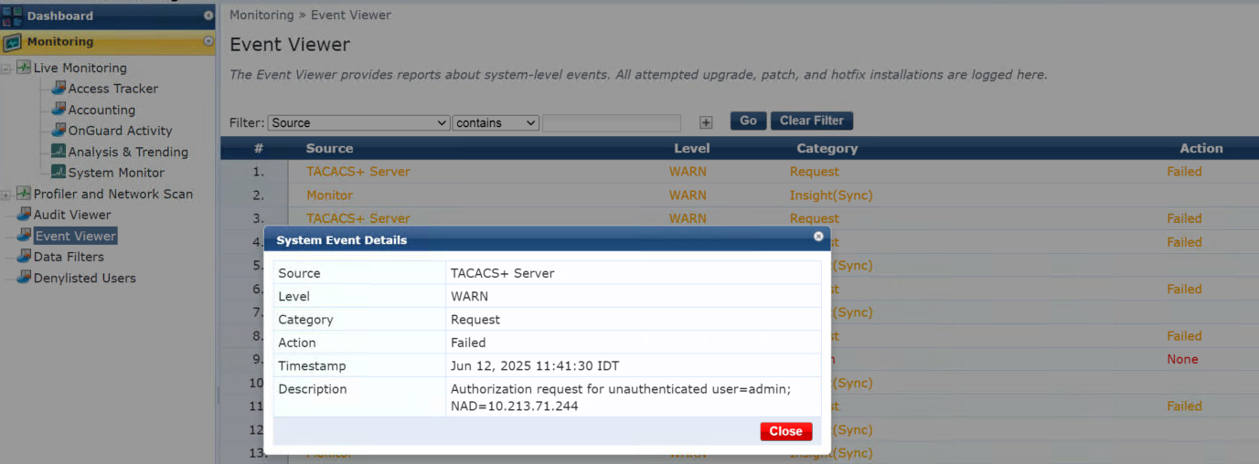

  • 8.  RE: Aruba central's user don't have authorization for some commands.
    Posted 26 days ago
    It wasn't on the Access tracker.
    I see it in the "Event Viewer".
    You can see here the message :
     There are some commands that trigger the Central to do it with the local admin user.
    I even open a TAC request and the said it is true, here is a quote from this case:
    1.Commands like reboot, firmware upgrade, and certain configuration changes are considered system-level operations.
    2.Aruba Central often executes these using the local admin account because it guarantees full access without relying on external authentication servers like TACACS
    3.Aruba Central automates tasks using pre-defined roles and credentials.
    4.If the switch is configured to use TACACS for command authorization, and Central tries to execute commands as
    admin, the mismatch causes failures unless admin is explicitly allowed in ClearPass.
    Best regards,
    Alon Haber
