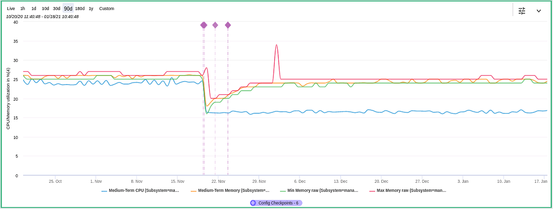

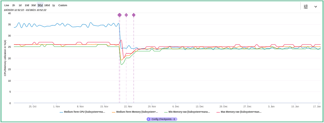

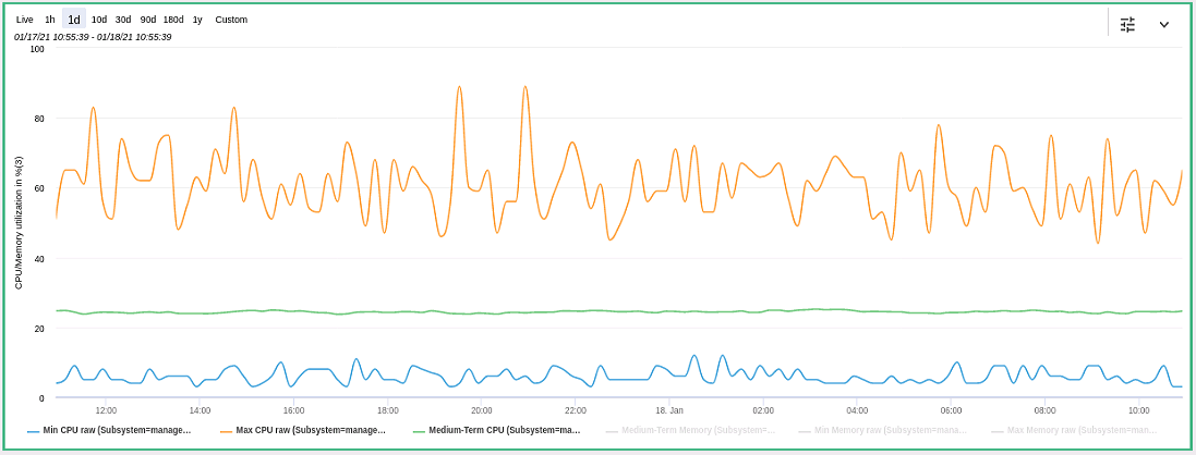

    Despite this trend (maximum CPU usage on VSX Primary looks high on the 1 Day time range, mid term it not):
    VSX Primary CPU 1 Day
    and the VSX Secondary trends of Max/Min/Mid terms CPU usage look quite the same (again over 1 Day time range):
    VSX Secondary CPU 1 Day
    If I look at latest 90 days time range the reports are quite reasonable and the medium term CPU usage values on both nodes slightly dropped after the upgrade we did (the steps you see on 22nd November were due to ArubaOS-CX upgrade to 10.05.0021):
    VSX Primary CPU 90 Days
    VSX Secondary CPU 90 Days
    I've no clue if what you're observing is something alarming or not...I mean...it looks like watching at top cpu and HPE IMC CPU graphs make things worst than perceived by looking at NAE graphs.
